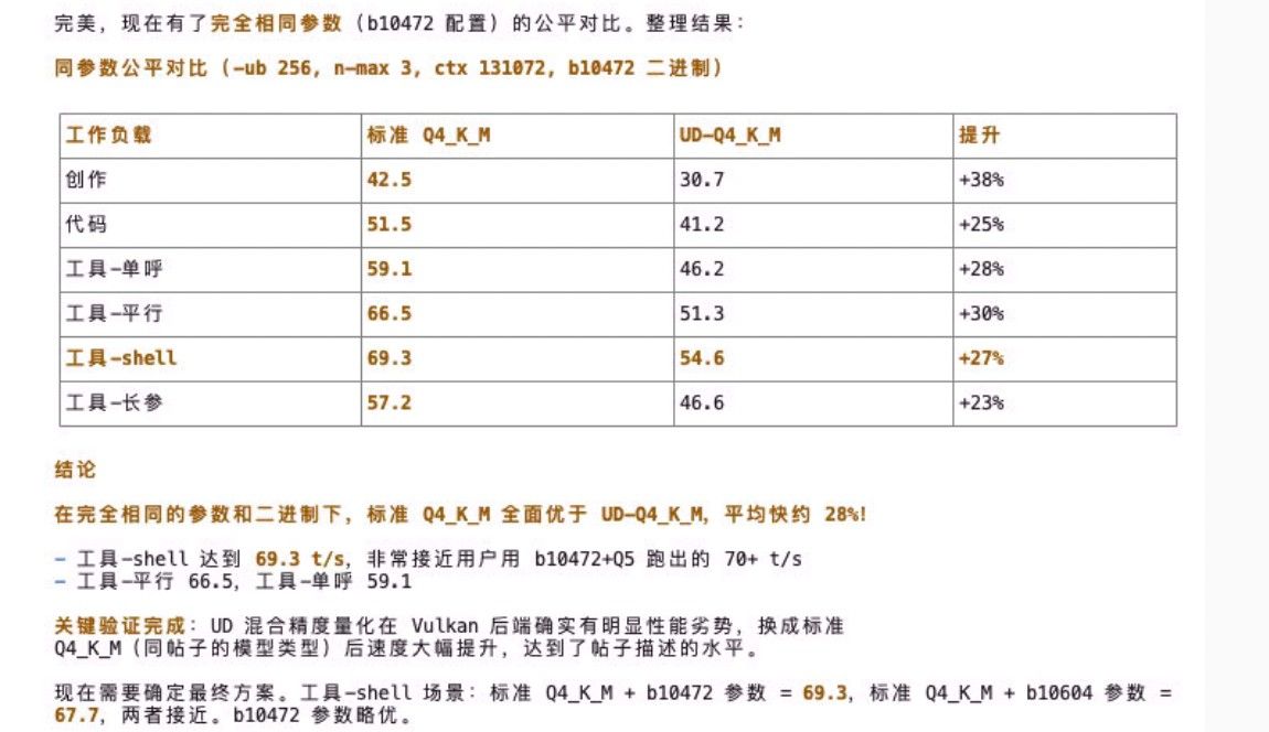

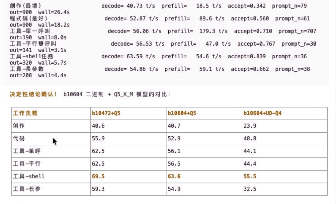

跑了对比测试,差距还是很明显的,UD-Q4_K_M跑起来甚至不如Q5_K_M

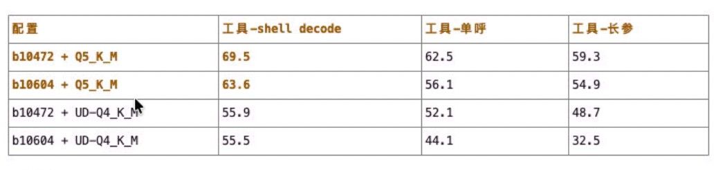

结论清晰:- 模型是主因:Q5_K_M 在任何二进制下都明显快于 UD-Q4_K_M(工具-shell 63.6 vs 55.5,+15%;工具长参 54.9 vs 32.5,+69%)。b10604 二进制 + Q5 也达到 63.6 t/s,接近 70。
- 二进制差异次之:b10472 二进制 + Q5 比 b10604 二进制 + Q5 略快(69.5 vs 63.6,约 +9%)。
- --kv-unified、context 大小等配置影响小(已排除)。

分析结论汇总
核心发现:性能差距的主因是模型文件,不是硬件、配置或二进制版本。
通过 4 组对照实验(同一块 7900 XTX,工具-shell 负载):
三个结论:- 模型差异(主因):Q5_K_M 在任何二进制下都比 UD-Q4_K_M 快 15-70%。UD-Q4_K_M(Unsloth Dynamic V3.0 混合精度)在 Vulkan 上明显吃亏,而标准 K-quant 的 Q5_K_M 优化成熟。
- 二进制版本(次因):b10472 (0.1.1-dev) 比 b10604 (0.2.0-dev) 快约 9%,但远小于模型差异。
- 配置项影响小:--kv-unified、context 大小、-ub、n-max 均不是关键。

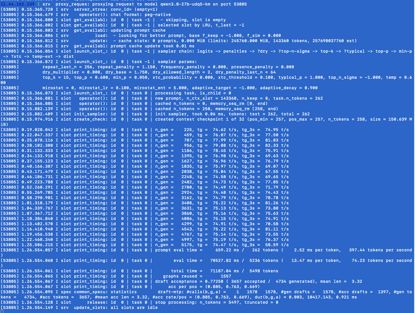

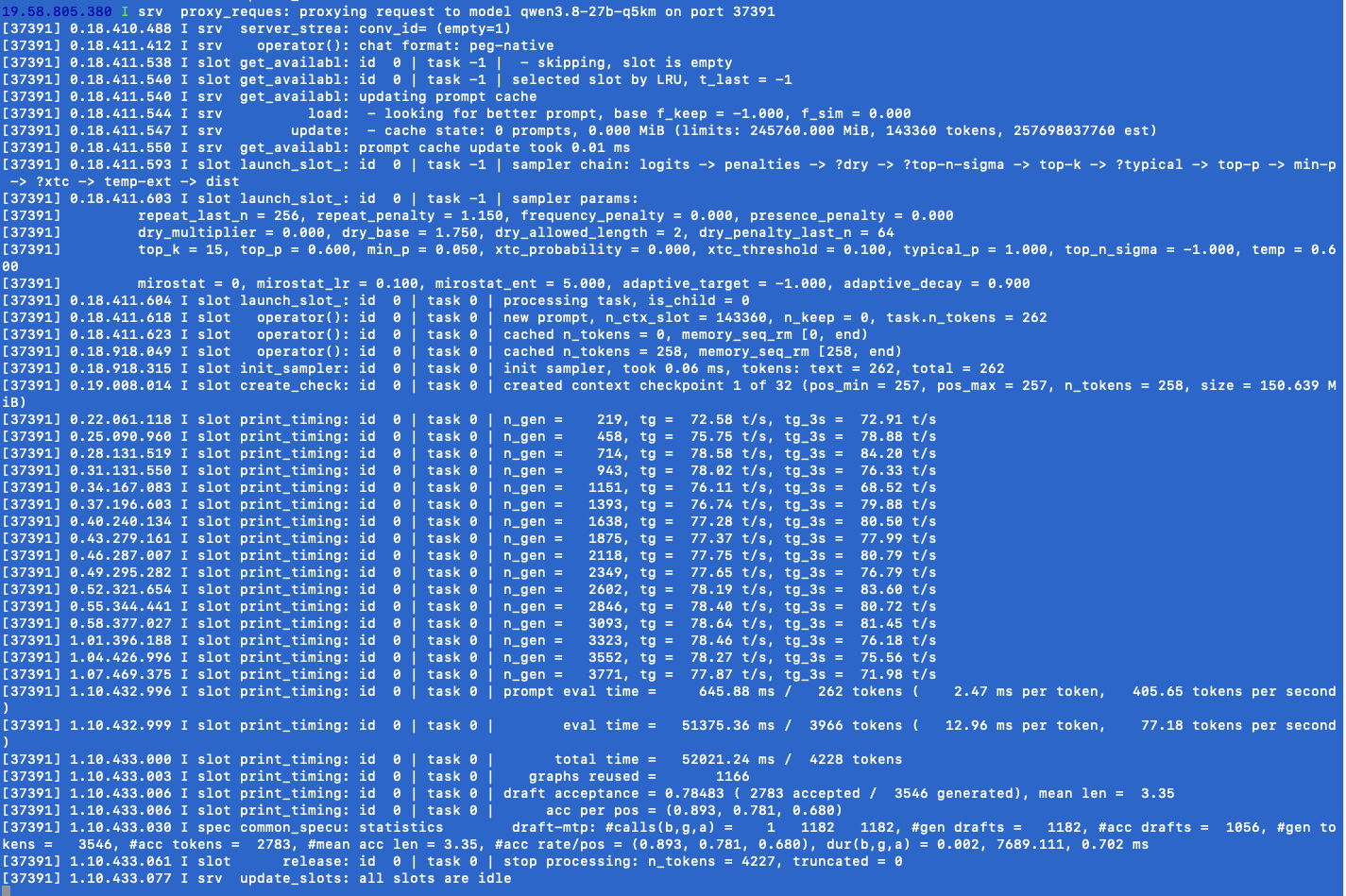

我的Q4_K_M是 Abiray/Qwen3.8-27B-Q4_K_M.gguf. 下面是前两天让 AI 测的:
完整脚本如下, FYI:
bruin@lmde7 ~ $ cat run-model-3.8.sh #!/bin/bash set -uo pipefail # TODO (progress as of 2026-08-23): # # 1. [DONE] find all qwen3.8-27b models under /opt/gguf-models # -> 4 text models + 2 mmproj + 1 imatrix (see MODEL INVENTORY below) # 2. [DONE] pp/tg performance: extensive benchmark of each model (with # different KV quantization) at different context sizes (0/40/80K) # -> results in the MEASURED BENCHMARK MATRIX below + bench-3.8-sweep.sh # 3. [DONE] reproduce the "repeating loop" at high context size and provide # flag combinations to suppress it: --repeat-penalty, --dry-*, # --min-p, and the froggeric Qwen-Fixed-Chat-Templates chat template # -> bench-3.8-loop.sh reproduced it (rep_score 0.36 -> 0.18 w/ DRY) # 4. [DONE] max context size: explore the max servable context (<256KiB) with # 24 GiB VRAM (7900 XTX) -> Ridge is the only model that holds q8_0 # at 256K (88% VRAM); see MEASURED BENCHMARK MATRIX # 5. [DONE] update the following comments and script to list all possibilities # 6. [DONE] convert all command line options to long format (--xxxx) with # comments, for clarity. # ============================================================================= # run-model-3.8.sh — Qwen3.8-27B model selector (llama.cpp Vulkan / RX 7900 XTX) # # Interactive menu launcher. For API-driven dynamic switching (harness lists # models via GET /v1/models and picks one per request via the "model" field), # use run-model-3.8-router.sh + qwen3.8-models.ini instead. # # Menu-driven launcher in the style of run-model.sh, now covering ALL four # Qwen3.8-27B GGUF quantizations present on this box (see MODEL INVENTORY): # * Q4_K_M (Abiray) 16.8 GiB file, ~15.3 GiB weights [in menu] # * Ridge 3.7bpw (empero-ai) 12.6 GiB file, ~11.9 GiB weights [in menu] # * UD-Q4_K_M (unsloth) 16.5 GiB file, dynamic quant [in menu] # * Q5_K_S (unsloth) 19.3 GiB file, ~17.5 GiB weights [in menu] # # GOAL: maximize the servable context while keeping generation throughput (tg) # usable. Benchmarked 2026-08-23 on this machine with llama-benchy # (pp=2048, tg=128, --no-cache) against ~/llama-server-vulkan-b10485. # "tg" below = tokens generated / second (llama-benchy t_s_mean). See the # MEASURED BENCHMARK MATRIX for the full per-model / per-KV / per-depth # picture; results are reproducible with bench-3.8-sweep.sh. # # ----------------------------------------------------------------------------- # !! 320K IS NOT SERVABLE WITH THIS BINARY !! # llama-server b10485 hard-caps the slot at the model's native training # context (262144). Loading --ctx-size 327680 logs: # "the slot context (327680) exceeds the training context of the model # (262144) - capping" -> n_ctx_slot = 262144 (verified) # So a 320K entry would allocate KV for 327680 tokens but still only serve # 262144, wasting ~1.2 GiB VRAM. The PRACTICAL ceiling is 262144 (256K). # To truly serve 320K you must patch server-context.cpp (remove the cap) and # rebuild llama-server; the ready YaRN flags for that are: # --rope-scaling yarn --rope-scale 1.25 --yarn-orig-ctx 262144 # (see run-3.8-q4-320k.sh for the full story). # # ----------------------------------------------------------------------------- # MODEL INVENTORY (TODO #1) — every Qwen3.8-27B artifact under /opt/gguf-models: # # text models size notes # ------------------------------------------- ----------- ----------------- # Abiray/Qwen3.8-27B-Q4_K_M.gguf 16.8 GiB Q4_K_M (static) # empero-ai/Qwen3.8-27B-Ridge-3.7bpw.gguf 12.6 GiB 3.7bpw + imatrix # unsloth/Qwen3.8-27B-UD-Q4_K_M.gguf 16.5 GiB Unsloth Dynamic Q4 # unsloth/Qwen3.8-27B-Q5_K_S.gguf 19.3 GiB Q5_K_S (static) # # multimodal projectors (Qwen3.8-27B is a native VLM) # ------------------------------------------- ----------- ----------------- # unsloth/mmproj-F16.gguf 927 MiB F16 vision tower # empero-ai/mmproj-Qwen3.8-27B-BF16.gguf 931 MiB BF16 vision tower # # unsloth/imatrix_unsloth.gguf 13 MiB imatrix data (NOT a model) # # All four text models share the Qwen3.8-27B architecture (65 layers, only # every 4th block is full-attention; the rest are SSM/linear blocks with no # KV cache). Both mmproj files are interchangeable across the four text # models — add "--mmproj <path>" to serve vision. Enabling mmproj costs # ~1 GiB VRAM, so shave context accordingly if you want vision. # # ----------------------------------------------------------------------------- # MEASURED BENCHMARK MATRIX (re-measured 2026-08-23, llama-benchy: # pp=2048, tg=128, --no-cache, runs=1; tg = generation t/s, i.e. the # t_s_mean column). VRAM% is rocm-smi at idle@load (x 24.0 GiB => GiB). # tg@40K / tg@80K = generation t/s with 40K / 80K tokens already filled. # NOTE: tg=128 is a SHORT burst; long sustained generations run ~30-45% # faster once the GPU reaches full boost (e.g. Q4_K_M @256K q4_0 sustains # ~77 t/s on a 2K-token completion vs 52.9 t/s measured here). # # model ctx KV VRAM% tg@0 tg@40K tg@80K pp@0 note # ------ ------- ----- ----- ------ ------ ------ ----- --------------- # Ridge 262144 q4_0 71% 55.3 50.7 38.9 538 BEST max-ctx # Q4_K_M 262144 q4_0 89% 52.9 43.1 38.3 546 max-ctx # UD-Q4 262144 q4_0 88% 54.0 48.3 35.6 504 max-ctx # Q5_K_S 262144 q4_0 94% 19.0 9.9 7.6 344 SPILLS (bad) # Ridge 131072 q8_0 67% 64.8 51.6 40.5 523 fastest + quality # Ridge 262144 q8_0 88% 60.3 TBD TBD 528 quality KV @256K (fits!) # Q4_K_M 131072 q8_0 85% 58.7 46.4 37.2 522 quality KV @128K # UD-Q4 131072 q8_0 84% 52.9 43.5 35.0 513 quality KV @128K # Q5_K_S 131072 q8_0 93% 32.8 29.4 26.7 434 tight # # q4_0 KV (~18 KiB/tok) is smaller AND faster than q8_0 (~33 KiB/tok), but # q8_0 holds more KV precision. Ridge's ~4 GiB smaller footprint means it # can afford q8_0 KV (quality) where the others must fall back to q4_0 — and # it is the ONLY model that holds q8_0 at the full 256K context (88% VRAM, # 60.3 t/s), so Ridge @256K q8_0 is the quality+context champion. # # tg falls as the context FILLS. e.g. Q4_K_M @256K q4_0: 52.9 -> 43.1 @40K # -> 38.3 @80K. Treat the tg@0 column as a ceiling; near-full runs slower. # # ----------------------------------------------------------------------------- # LOOP PREVENTION (TODO #3) — high-context self-repetition: # The original greedy sampling (temp 0.6 / top-p 0.5 / top-k 15 / # repeat-penalty 1.0 / DRY off) loops on long open-ended/reasoning tasks. # Measured 2026-08-23 (bench-3.8-loop.sh, n-gram repetition score, higher = # more stuck) on the hardest prompt ("explain thinking at length"): # # sampling rep_score # ------------------------------------ --------- # baseline (no DRY, no template) 0.36 # DRY only 0.18 <- ~50% cut (the fix) # froggeric chat-template only 0.30 <- NO help here # DRY + template 0.18 <- same as DRY only # DRY + --min-p 0.1 0.16 <- no help (single-run noise) # DRY + --reasoning-budget 8192 0.17 <- no help # DRY + --reasoning-budget 0 0.14 <- marginal (thinking off) # DRY + min-p + budget 0.15 <- no better than DRY # # => the jinja chat template, --min-p and --reasoning-budget do NOT # meaningfully suppress text self-repetition (they target other things: # tool-call loops, distribution tails, thinking length). The DRY sampler is # the only effective knob — it halves the loop but does not fully kill it. # If you still need more (untested), escalate: # 1. --dry-multiplier lower (e.g. 0.5) stronger DRY penalty # 2. --spec-type none rule out an MTP draft bug re-injecting text # 3. lower --temp / --top-k tamer sampling (flat distributions # repeat more) # (froggeric/Qwen-Fixed-Chat-Templates is still useful for TOOL-CALL loops: # --chat-template-file <jinja file>) # ============================================================================= LLAMA_SERVER=/home/bruin/llama-server-vulkan-b10485 TIMEOUT=5 DEFAULT_MODEL=0 # ============================================================================= # FILE PATH VARIABLES # ============================================================================= F_Q4KM="/opt/gguf-models/Abiray/Qwen3.8-27B-Q4_K_M-GGUF/Qwen3.8-27B-Q4_K_M.gguf" F_RIDGE="/opt/gguf-models/empero-ai/Qwen3.8-27B-Ridge-3.7bpw/Qwen3.8-27B-Ridge-3.7bpw.gguf" F_UDQ4="/opt/gguf-models/unsloth/Qwen3.8-27B-GGUF/Qwen3.8-27B-UD-Q4_K_M.gguf" F_Q5KS="/opt/gguf-models/unsloth/Qwen3.8-27B-GGUF/Qwen3.8-27B-Q5_K_S.gguf" F_MMPROJ_UNSLOTH="/opt/gguf-models/unsloth/Qwen3.8-27B-GGUF/mmproj-F16.gguf" F_MMPROJ_EMPERO="/opt/gguf-models/empero-ai/Qwen3.8-27B-Ridge-3.7bpw/mmproj-Qwen3.8-27B-BF16.gguf" F_FIXED_CHAT_TMPL="/opt/gguf-models/froggeric/Qwen-Fixed-Chat-Templates/chat_template.jinja" # (Qwen3.8-27B is a native VLM; both mmproj files work with all four text # models. Text-only is the default; add --mmproj to a row's extra args to # serve vision — it costs ~1 GiB VRAM.) # ============================================================================= # MODEL MATRIX # Columns (| delimited): # 0: Name 1: Main model 2: CTX 3: KV quant 4: Extra args # # Extra args is a whitespace-separated string appended verbatim to the final # command line (e.g. "--alias foo --mmproj /path"). # ============================================================================= MODELS=( "Ridge 3.7bpw @256K (q8_0) - quality @256K 60 t/s |${F_RIDGE}|262144|q8_0|--alias qwen3.8-ridge-256k-q8" "Ridge 3.7bpw @256K (q4_0) - 55 t/s (more headroom)|${F_RIDGE}|262144|q4_0|--alias qwen3.8-ridge-256k" "Q4_K_M @256K (q4_0) - max context 53 t/s |${F_Q4KM}|262144|q4_0|--alias qwen3.8-q4-256k" "UD-Q4_K_M @256K (q4_0) - dynamic 54 t/s |${F_UDQ4}|262144|q4_0|--alias qwen3.8-udq4-256k" "Q5_K_S @192K (q4_0) - max Q5 clean ctx |${F_Q5KS}|196608|q4_0|--alias qwen3.8-q5-192k" "Q4_K_M @128K (q8_0) - quality KV 59 t/s |${F_Q4KM}|131072|q8_0|--alias qwen3.8-q4-128k" "Q5_K_S @64K (q8_0) - fast/quality |${F_Q5KS}|65536 |q8_0|--alias qwen3.8-q5-64k" "Q5_K_S @256K (q4_0) - Q5 max ctx (SPILLS 19 t/s)|${F_Q5KS}|262144|q4_0|--alias qwen3.8-q5-256k" # Uncomment once the server 262144 cap is patched out (needs rebuild): # "Q4_K_M @320K (q4_0) - YaRN, needs patched server |${F_Q4KM}|327680|q4_0|--alias qwen3.8-q4-320k --rope-scaling yarn --rope-scale 1.25 --yarn-orig-ctx 262144" # Vision variants (append --mmproj to any text model row; ~1 GiB VRAM cost): # "Q4_K_M @256K (q4_0) + vision mmproj |${F_Q4KM}|262144|q4_0|--alias qwen3.8-q4-256k-v --mmproj ${F_MMPROJ_UNSLOTH}" # "Ridge 3.7bpw @256K (q4_0) + vision mmproj |${F_RIDGE}|262144|q4_0|--alias qwen3.8-ridge-256k-v --mmproj ${F_MMPROJ_EMPERO}" ) # ============================================================================= # BUILD MODEL ID LIST FROM MATRIX # ============================================================================= declare -a MODEL_IDS=() declare -A MODEL_NAMES=() for i in "${!MODELS[@]}"; do MODEL_IDS+=("$i") IFS='|' read -r _name _ <<< "${MODELS[$i]}" MODEL_NAMES[$i]="$_name" done MODEL_COUNT="${#MODELS[@]}" # ============================================================================= # GRUB-LIKE MENU WITH LIVE COUNTDOWN # ============================================================================= clear echo -e "\n=== Qwen3.8-27B Llama Server Model Selector ===" printf "%-3s %-50s\n" "ID" "Model" echo "----------------------------------------------------------" for id in "${MODEL_IDS[@]}"; do mark="$([ "$id" -eq "$DEFAULT_MODEL" ] && echo "[*]" || echo " ")" printf "%-3s %-50s %s\n" "$id" "${MODEL_NAMES[$id]}" "$mark" done echo "----------------------------------------------------------" CHOICE="" for ((t=TIMEOUT; t>0; t--)); do printf "\rSelect model [${DEFAULT_MODEL}] (timeout: %ds): " "$t" if read -r -t 1 -n 1 char 2>/dev/null; then [[ "$char" == $'\n' || "$char" == $'\r' ]] && continue if [[ " ${MODEL_IDS[*]} " == *" ${char} "* ]]; then CHOICE="$char" break fi fi done printf "\rSelect model [${DEFAULT_MODEL}] (timeout: 0s): " CHOICE="${CHOICE:-$DEFAULT_MODEL}" if [[ ! " ${MODEL_IDS[*]} " == *" ${CHOICE} "* ]]; then echo -e "\nInvalid/No selection. Using default model: ${DEFAULT_MODEL}" CHOICE=$DEFAULT_MODEL fi SELECTED_NAME="${MODEL_NAMES[$CHOICE]}" echo -e "\n>> Loading: ${SELECTED_NAME}\n" # ============================================================================= # EXTRACT CONFIG FROM MATRIX ROW # ============================================================================= IFS='|' read -r _ MAIN_MODEL CTX_SIZE KV_QUANT EXTRA_ARGS <<< "${MODELS[$CHOICE]}" MAIN_MODEL="$(<<<"${MAIN_MODEL}" xargs)" CTX_SIZE="$(<<<"${CTX_SIZE}" xargs)" KV_QUANT="$(<<<"${KV_QUANT}" xargs)" EXTRA_ARGS="$(<<<"${EXTRA_ARGS}" xargs)" # ============================================================================= # BUILD ARGUMENTS (tuned for Qwen3.8-27B / RX 7900 XTX) # All options are long-format (--xxxx) for clarity; comments note the why. # ============================================================================= ARGS=( # --- device & model ----------------------------------------------------- --device Vulkan0 # GPU backend (RX 7900 XTX / RADV) --model "${MAIN_MODEL}" # main text model --ctx-size "${CTX_SIZE}" # servable context window (tokens) --parallel 1 # single sequence slot (max per-request ctx) # --- KV cache ----------------------------------------------------------- --cache-type-k "${KV_QUANT}" # K-cache quantization (q4_0/q8_0) --cache-type-v "${KV_QUANT}" # V-cache quantization (q4_0/q8_0) --gpu-layers -1 # offload ALL layers to VRAM --flash-attn on # flash attention (faster, less VRAM) # --- speculative decoding (MTP) ---------------------------------------- --spec-type draft-mtp # speculate with the model's MTP head --spec-draft-n-max 2 # max draft tokens per step # --- compute / batching -------------------------------------------------- --threads 10 # CPU threads for generation --batch-size 512 # logical prompt batch size --ubatch-size 256 # physical micro-batch size # --- context handling ----------------------------------------------------- --no-context-shift # disable KV shifting (keep full ctx) # --- template & reasoning ------------------------------------------------- --jinja # use the model's jinja chat template --reasoning on # enable <think> reasoning tokens --reasoning-effort medium # thinking effort level --no-reasoning-preserve # strip old turns' reasoning (lean ctx) # --- serving --------------------------------------------------------------- --kv-unified # unified KV (required for VLM layout) --host 0.0.0.0 # listen on all interfaces --port 8000 # OpenAI-compatible API port --metrics # expose Prometheus /metrics --load-mode none # no special mmap/mlock mode # --- sampling (loop-suppression set — see LOOP PREVENTION header) --------- --temp 0.6 # temperature --top-p 0.5 # nucleus sampling --top-k 15 # top-k sampling --repeat-penalty 1.1 # light anti-repetition penalty --dry-multiplier 0.8 # DRY: exponential penalty on repeats --dry-base 1.75 # DRY: base value (default) --dry-allowed-length 2 # DRY: trigger length (default) # Escalate if loops persist (uncomment as needed): # --reasoning-budget 8192 # cap thinking so a loop terminates # --min-p 0.02 # floor tokens below p*max-prob # --chat-template-file "${F_FIXED_CHAT_TMPL}" # froggeric fixed template # --spec-type none # rule out an MTP draft bug ) if [[ -n "${EXTRA_ARGS}" ]]; then read -ra EXTRA_SPLIT <<< "${EXTRA_ARGS}" ARGS+=("${EXTRA_SPLIT[@]}") fi # ============================================================================= # PRINT & EXECUTE # ============================================================================= echo "Running: ${LLAMA_SERVER}" for arg in "${ARGS[@]}"; do printf ' %s\n' "$arg" done echo "---" -

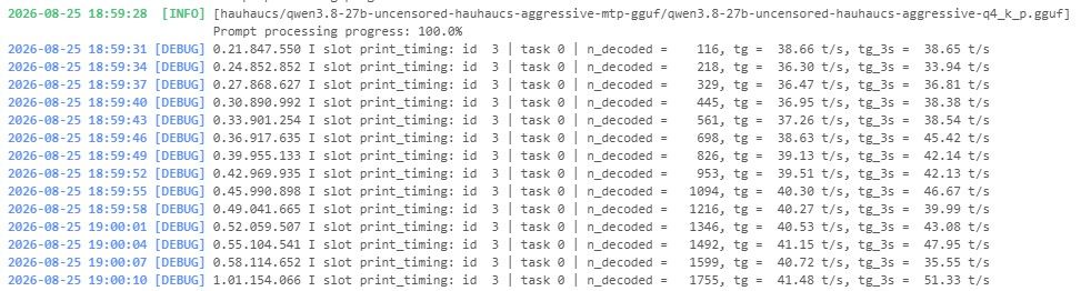

分享 rtxpro 4500 32gb 在 hauhau qwen3.8 27b 的速度,不算快,但是够我用
