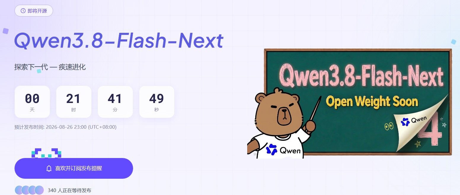

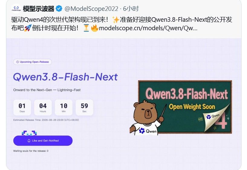

    https://modelscope.cn/models/Qwen/Qwen3.8-Flash-Next
    这会是DGX Spark的梦中情模吗?
