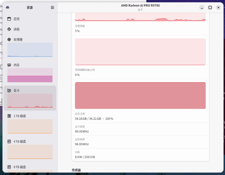

    ![3.png]
    涡轮噪音大,所以锁了250W功耗,性能大概下降10%
    (https://upload.lcz.me/uploads/277b6811-0238-47ee-af1a-3f183afac95b.png)
